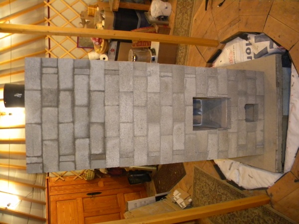

Got the facing done--it'll eventually get covered with plaster.
Now to cap the core:
If I can find reasonably priced chimney pipe around, I might be able to get it burning soon!

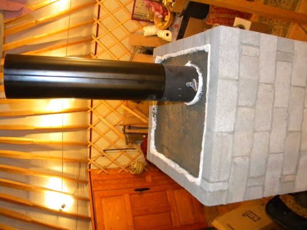

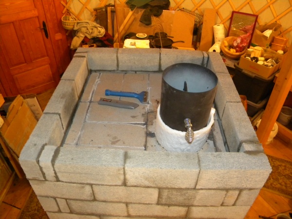

The heater is basically done now. Air inlet & cleanout ports are mortared in, firebox door is in place (screws in frame hold holes drilled in brick facing) & insulated, all doors/ports sealed on the outside with silicone to prevent air/smoke leakage.
Core is capped with ~3 inches of perlcrete & 1/2 to 1 inch of thinset mortar.
Now to get the chimney figured out. I was thinking of using leftover ceramic
insulation
to make my own double-wall chimney pipe, but the minimal stovepipe/chimney (~8 ft) might not give enough draft & I wouldn't easily make more. Plus good quality stainless steel pipe in the right sizes wouldn't really be cheaper. So I bought some chimney pipe...

I wondered about that--it's always good to check material properties. It looks like fiberglass insulation burns/melts about 1000 F (EngineeringToolbox, usually good general info), so it should technically have been alright. I thought I saw something about it really only being good to 600 F (melting temp?) or such though. The ceramic stuff I got for building the stove is rated to 2012F, so definitely good--but too much work for minimal savings :P
I got the chimney up, though I need to get the roof flap sealed up properly again. I'm learning to build fires in the dang thing, plus it's only supposed to get 1/3-1/2 firebox capacity the first week so it dries out slowly/doesn't break mortar joints. I'll post chimney pictures once I get it all sorted.
