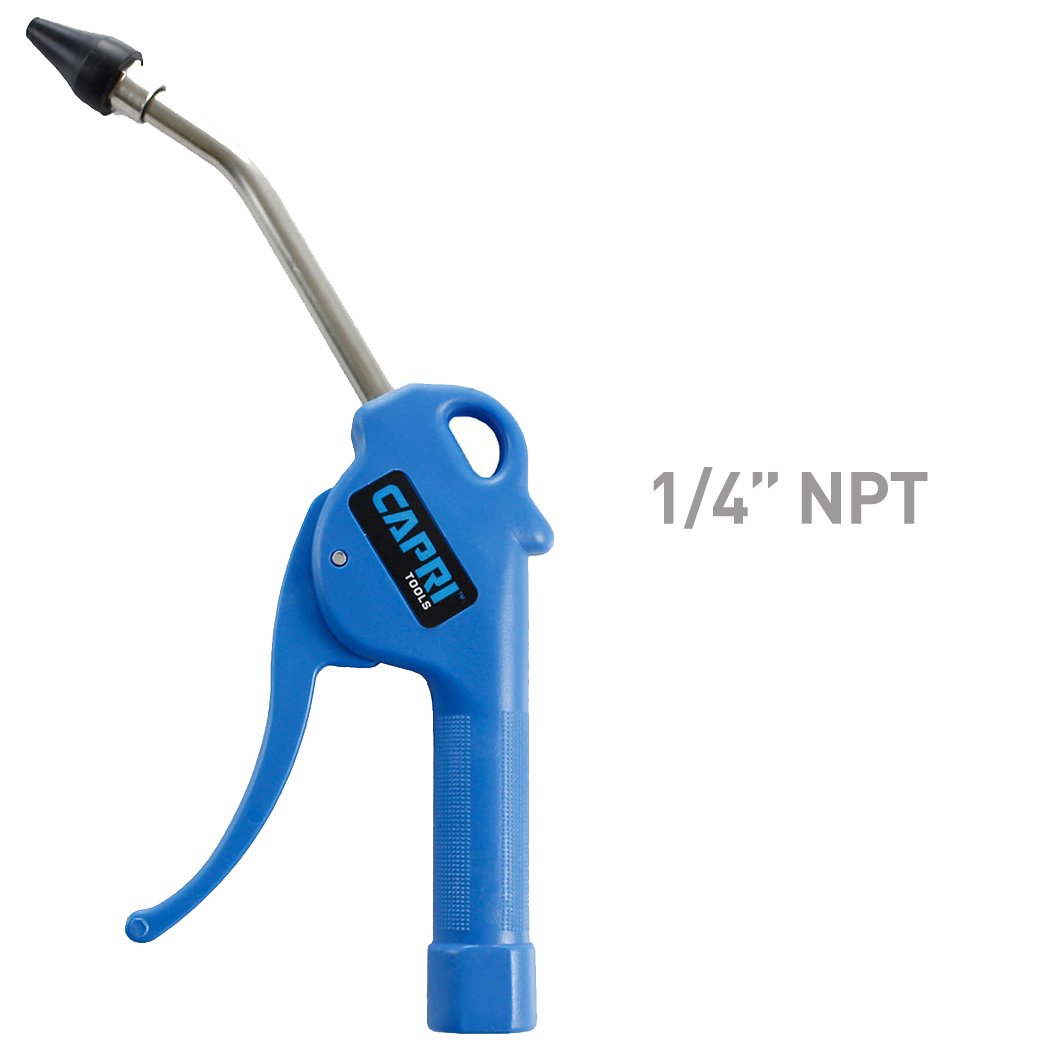

I use a compressor on my water systems. It isn't difficult. I use something like this with a rubber tip on the end:
(You can buy it here)
That way you can just stick it over the end of a pipe/line/fixture and blow air through it.
