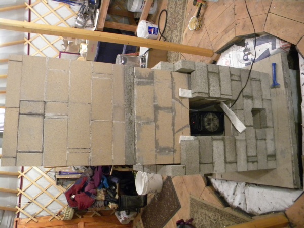

Concrete brick facing partially complete. ~1/4" air gap maintained between the core & facing using cardboard, which is removed after the mortar sets.
Masonry Heater
