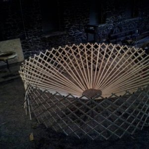

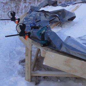

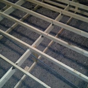

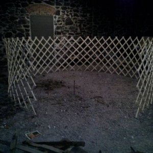

I used clamps as a jig, they helped keep my edges even around the yurt.

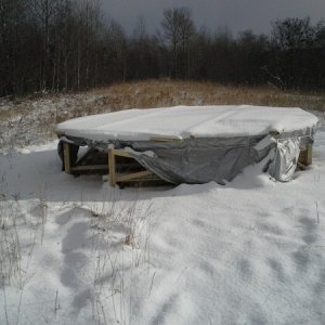

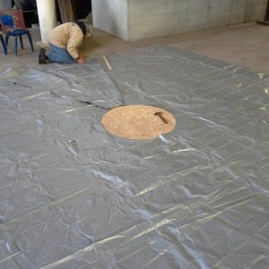

The temporary tarp in place (make your mistakes on the "cheap" stuff).

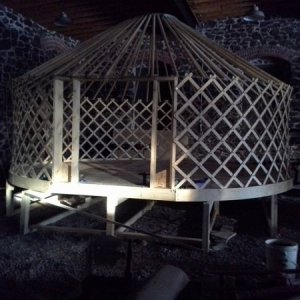

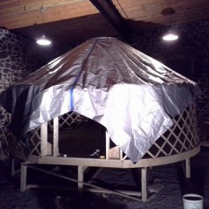

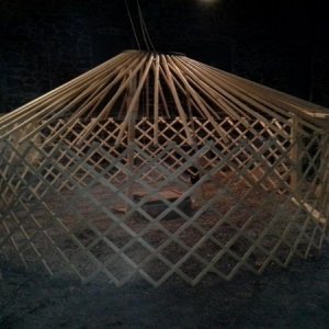

Remaining roof poles cut and placed.

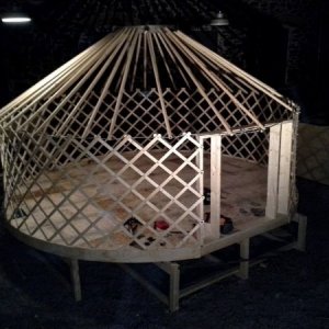

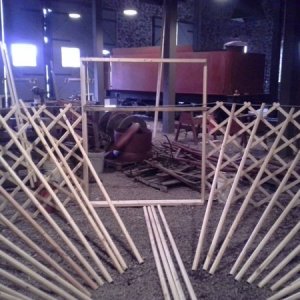

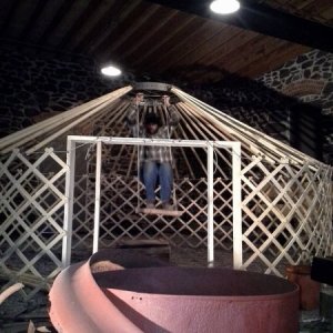

026 Test fitting the yurt.

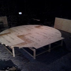

024 Trimming the plywood.

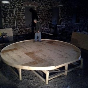

022 Framing the deck.

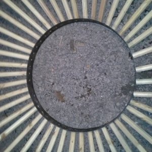

This is my roof ring. I have since welded four braces or spokes into the center.

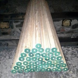

My roof poles were cut from 2x2s, I knocked the corners off on a table saw.

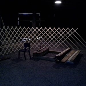

I knotted my lath.
I knotted my lath.

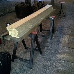

I ripped them.

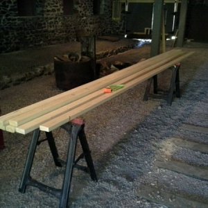

I started with 16 foot 2x4s.  They were clear of knots, the 8 footers were not.
