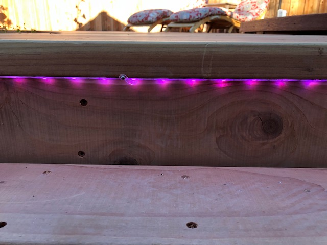

edge, and I think it looks integral. My father recommended running the redwood boards tight together, and after they dry out for a season they will have a nice 1/4" gap. I had done that on other decks, and it not only looks great after seasoned, but is much faster to lay without worrying about spacing. The deck has LED light strips, currently red in color that makes the deck / yurt seem a bit like a UFO landing. more on LED's below.

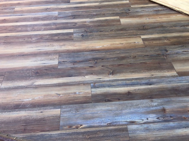

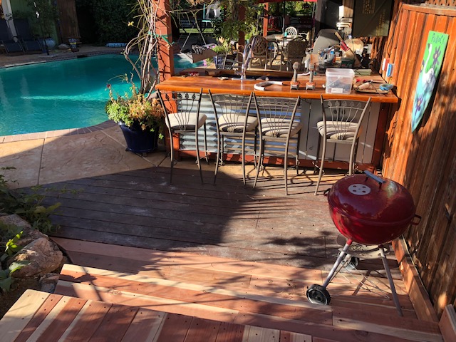

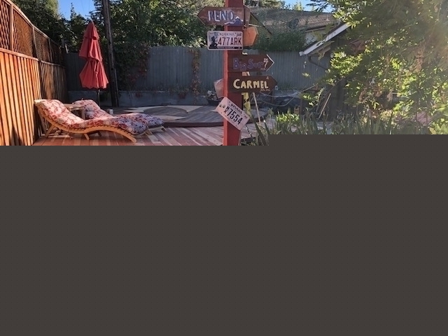

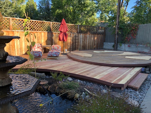

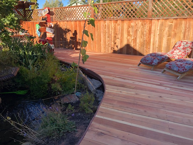

Finished the platform, and the deck. LED downlighting around the entirety of the deck. For the platform, we choose a weathered looking engineered floating floor with a built in pad. A few photos from the weekend. I used Trex bender board around the platform as my drip edge, and used brown silicon to create a seal between the drip edge and flooring. Yurt gets delivered tomorrow.

Old 09-23-2018, 09:45 PM   #5
Join Date: Nov 2013
Posts: 2,210
Default Re: Newbie, my build notes / Pacific Yurts 16ft
Good job. You have a nice place there. I especially like the water feature. Looking forward to seeing the yurt install. Thanks for the photos so far.

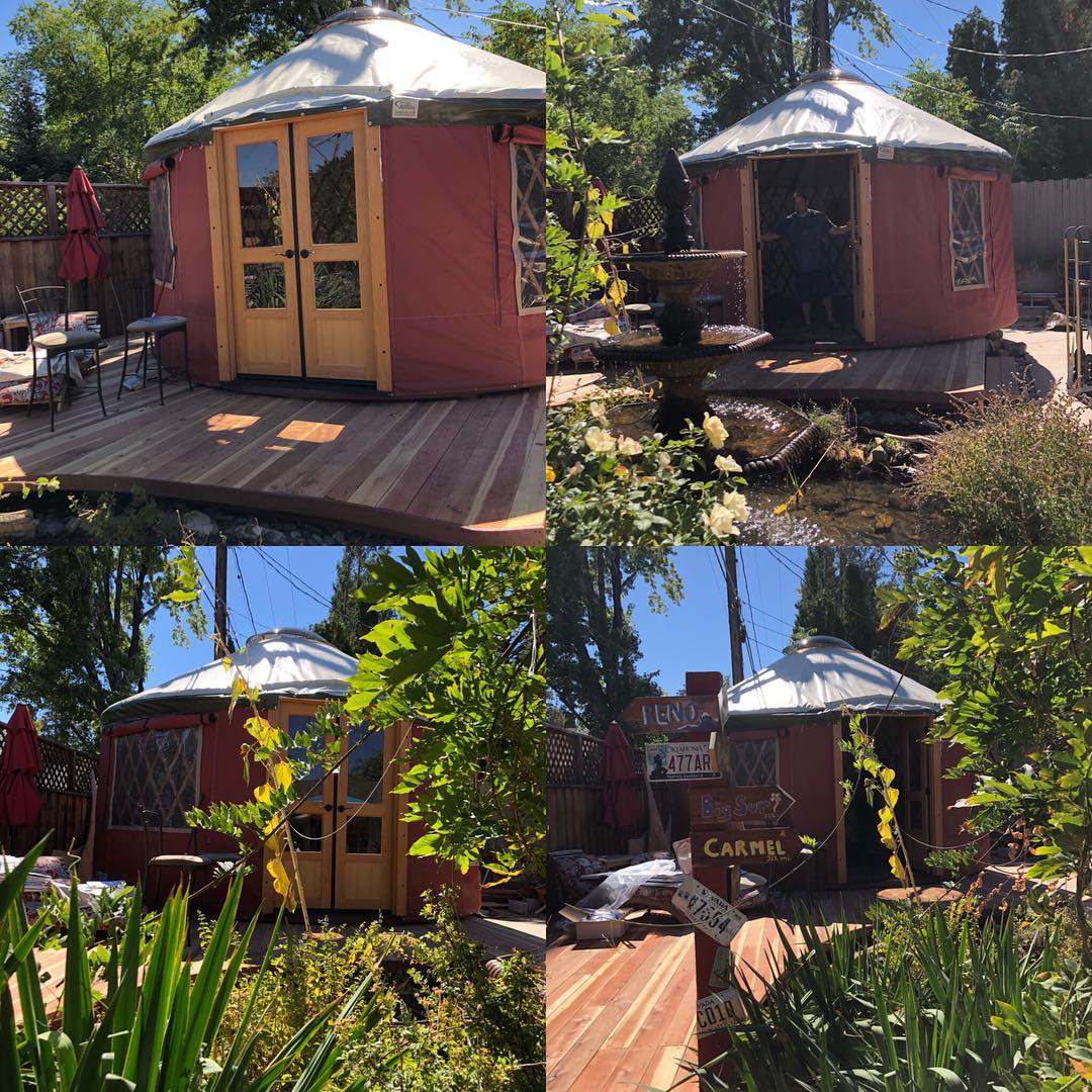

Thanks for the advice. The trex bender was 1/2" so seemed to be fine with the brackets. I also used weatherstripping on the base, and everything turned out very weatherproof. It took about 5 hours to erect, great instructions by Pacific Yurts, thank you! More pics to come, but here is first view.
